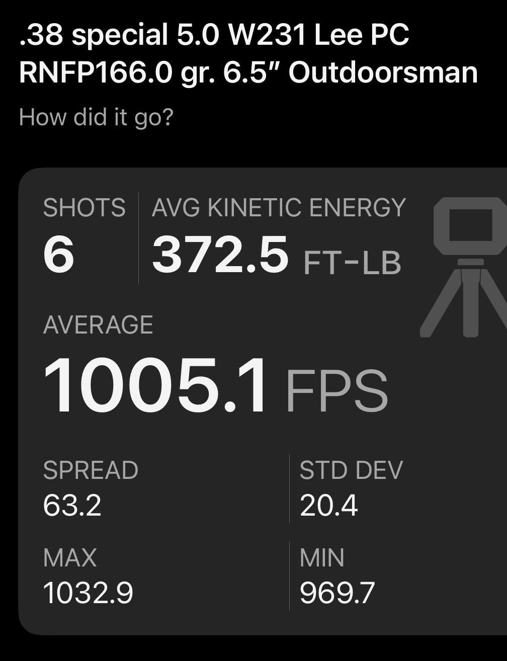

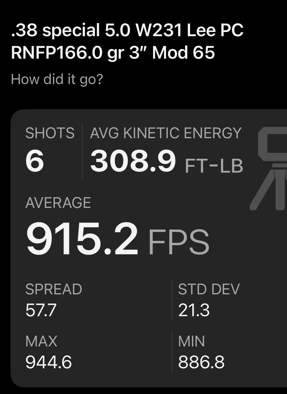

by Slow Hand ⌂ @, Indiana, Thursday, March 05, 2026, 13:24 (28 days ago) @ BobM
Bob, one of the first loads I tried in my new Blackhawk, and a few other guns was 5.0 of W231 over my Lee RNFP cast bullet tha runs about 165 with my alloy. I shot them in .38 and .357 cases with similar results. Shot in 6.5” NMBH, Outdoorsman and a 3” model 65.
My results…
by Slow Hand ⌂ @, Indiana, Thursday, March 05, 2026, 13:25 (28 days ago) @ Slow Hand
Sorry for the huge pics. I’m on my phone and don’t know how to resize them. Maybe Paul can shrink them down to a more manageable size!
