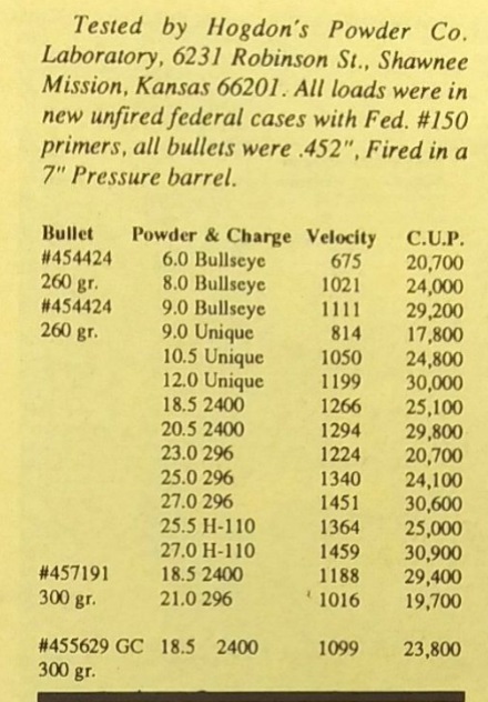

Years back John Linebaugh helped me get .45 Colt loads pressure-tested at Hodgdon's in their pressure barrel. John had built the pressure barrel for them and had access to it whenever they weren't running tests.

by JimT, Texas, Tuesday, October 28, 2025, 09:50 (156 days ago) @ Hoot
The 300 gr. #45191 bullet was seated only deep enough to crimp into the top grease groove.

Thanks, I love reading pressure data, interesting to see the pressure jumps with slight powder increase. One of the reasons I like older reloading manuals, they included pressure data on the loads.

by Slow Hand ⌂ @, Indiana, Tuesday, October 28, 2025, 17:14 (156 days ago) @ JimT
Thanks for posting that. It’s surprising to see the bullseye pressure so high, especially for the velocity. MTter fo fact, I don’t see any that are under max pressure for standard 45 colt loads. I know red dot and bullseye are pretty close and ,y standard lighter .45 colt load is 6.0 of red dot under a 454424. I wonder how it is for pressure.

by Slow Hand ⌂ @, Indiana, Saturday, November 01, 2025, 07:48 (152 days ago) @ JimT
I finally got around to trying out some of his hotter loads yesterday. They were pretty snappy and I seriously doubt I will be doing that again! Maybe for use in my 1894 Marlin because they were much more controllable in it and produced some very impressive velocities!
I loaded 24.0 of H110 under a 454424 and got 1276 fps, which is impressive how close it was to the hotter load in your chart.
I also loaded a Lee 320 rnfp-gc over 23.0 and got just over 1200 FPS. These were in my 4-5/8” NMBH.
