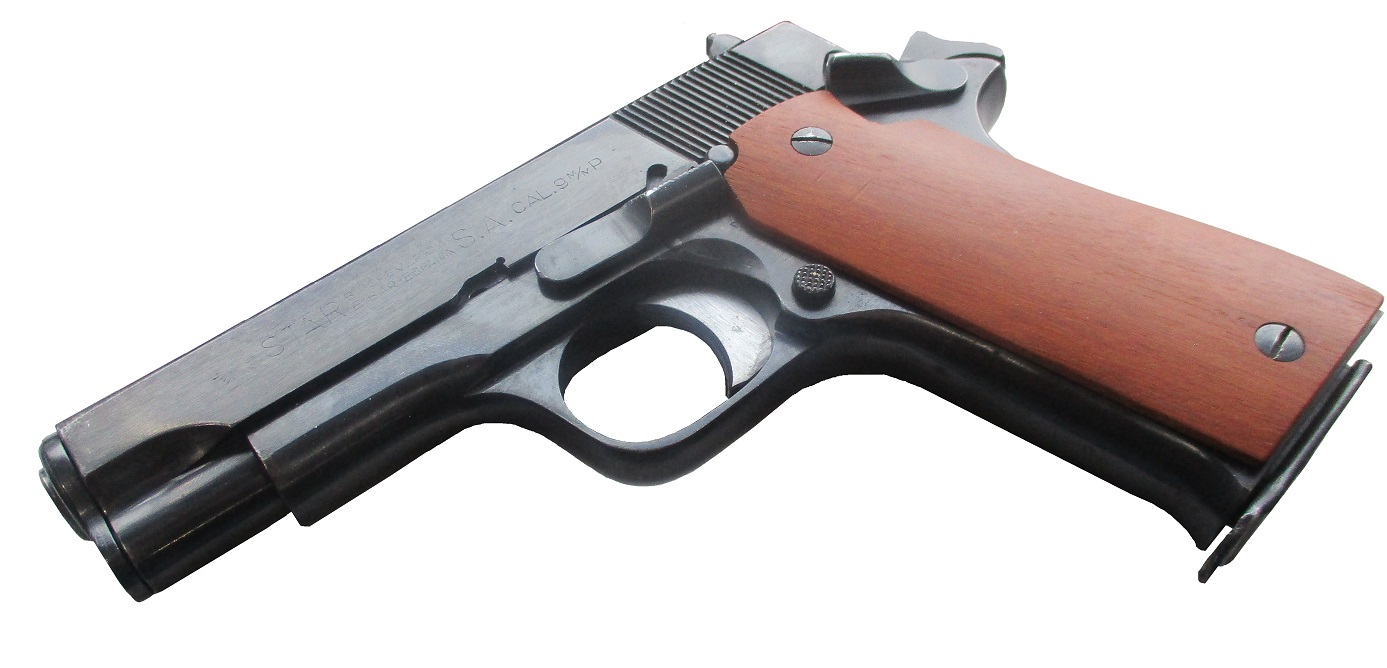

For some weird reason I have been messing with the 9mm again after staying away from them for more than 20 years. A few years back I ran across a deal on a Star BM. J&G Sales had them for less than $300 and I bought one. Turned out to be a nice gun and it worked well. I added a set of wood stocks on it and stuck it in my safe. I have taken it out and shot it now and then. In truth, I shoot my .22's more.
I call it my "NotaGlock"

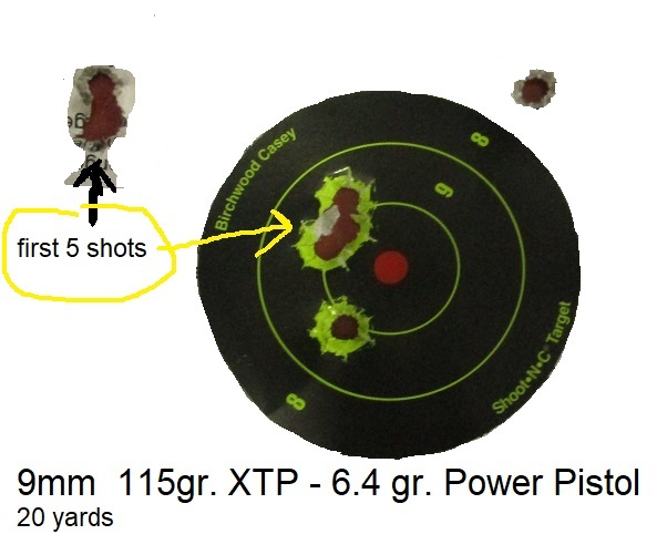

Using Winchester cases and Winchester Small Pistol primers I started with 5.8 gr. ... 6.1 gr. and 6.4 gr. ... carefully watching the overall length. The 9mm is such a small case and loading density is so high that a small deviation in the overall loaded length can make a large difference.
On the range using the Star BM and a Kahr CW9 all loads functioned well with no hangups or jams. There was a notable difference between the lightest and heavier loads, both in recoil and where they hit in relation to the Point Of Aim. The 6.4 gr. load proved the most accurate from the Star and hit about an inch above the POA at 20 yards.
The first 5 shots I somehow put 3 together in the black, then pulled 2 out. I was sitting at a table, resting my left elbow on the table and holding the gun with both hands. After I fired those 5 I had two shells left and stood up and shot them offhand, putting one in the black and one high right.
I am going with the 6.4 gr. loading. I have no desire to hotrod the 9mm. The velocity will be somewhere around 1200 fps and that's not the critical thing to me. The reliability first and the accuracy second is what I am judging by.
