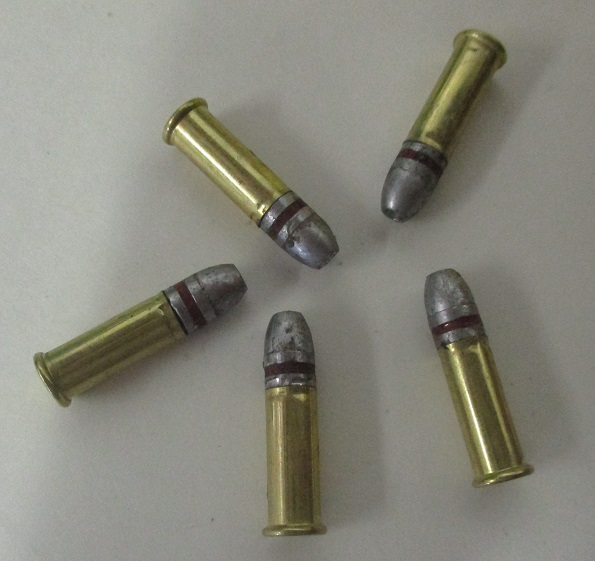

I have been reloading them with cast 38gr. and 45 gr. gascheck bullets intended for the 5.56. I use the gascheck step as the "heel" and crimp them into it. With 2 gr. of Bullseye the 38 gr. bullet runs just under 1500 fps from my 6" Single Six. The Russian cases are steel so they hold the high pressure. I am sure if they were brass I would have blown the case heads.
