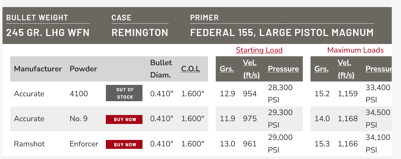

by RayLee, Saturday, June 24, 2023, 12:10 (1014 days ago) @ A K Church
https://shootersreference.com/reloadingdata/41-remington-magnum/
Shows some heavy bullet loads 240 to 265 gr. but nothing mild. I've always been puzzled by the lack of less intense data for .41 magnum in the manuals. A very wise person once wrote that.44 special powder weights work for milder .41 loads.
