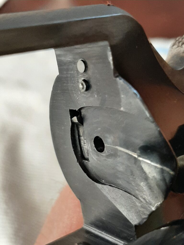

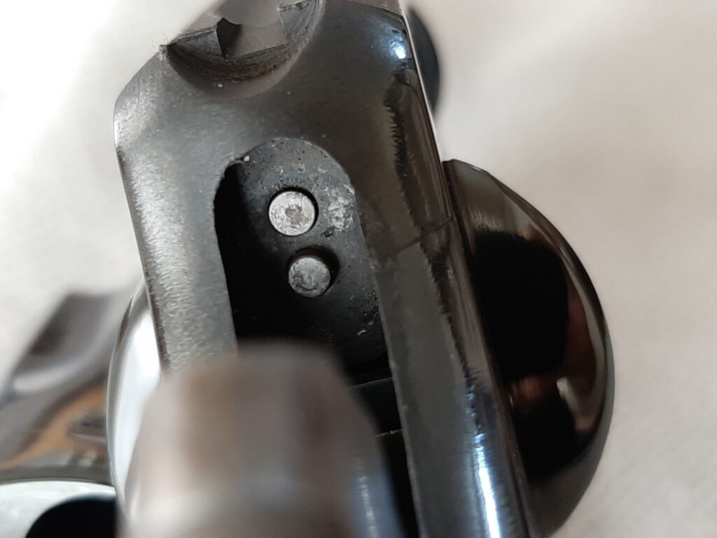

It had an automatic block driven by the hammer, to limit the amount of rearward travel the aggressively tapered 9mm case could take, apparently preventing the lockup some other 9mm revolvers have experienced. Looked like a round solid flat tipped pin just above the firing pin hole.

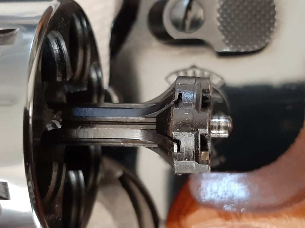

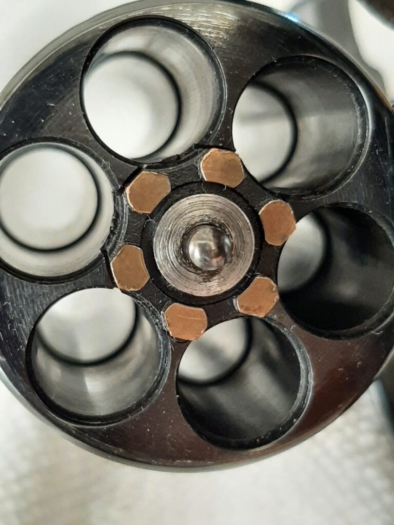

It also had a complex extractor, with lugs which entered the extractor groove on the case under spring pressure. This both extracted and headspaced the cartridges w/o the use of clips.

I've seen one in my whole life, at the range in early 90s. The user claimed it ran perfectly. I got to look at the marvelously made extractor, which reminds me of nothing so much as a Ruger No 1 extractor for a rimless case, but miniaturized and repeated 6 times. I did not think, best I recall, to look at the limiter block.

Firing Pin and Block
from the shooter's viewpoint

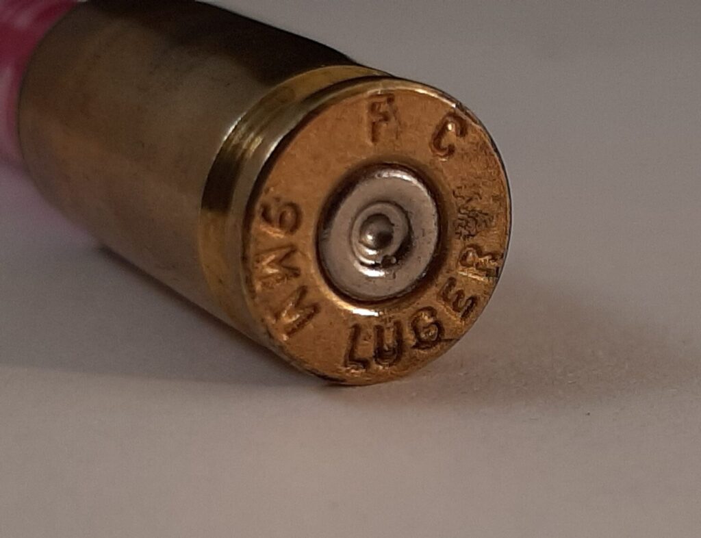

A fired cartridge showing the unique marks
Extractor
Extractor
